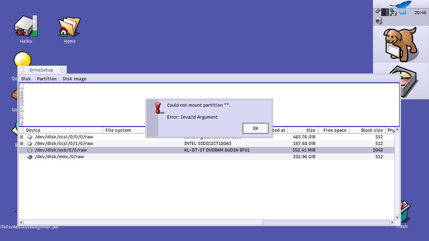

[ANSWERED] Is it possible to mount a USB optical drive?
When I am ripping WAV files from audio CDs, I’ve found that Haiku (hrev 59378 Walter (x86_64)) recognises an internal optical drive but not an optical drive connected to my PC via USB cable. Is there some way to set up Haiku to recognise USB optical drives?
My computer is a Lenovo Thinkpad X230
The internal drive that I’ve successfully used is the Lenovo DVD Multi IV, a serial Ultrabay Slim drive installed in the Thinkpad’s Ultrabase dock.

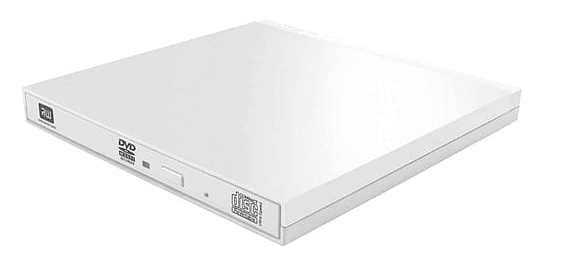

The USB drive that I’ve not had success with connecting is the Logitec LDR-PUE8U3LWH.

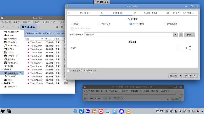

When I connect this particular optical drive to a Windows 10 or a FerenOS (Ubuntu-based Linux distro), they seem to have USB drivers which can read the drive, as I am able to play back the music CD using VLC. On the other hand, Haiku and GhostBSD (based on FreeBSD) are unable to read the files on the music CD contained in the USB optical disc drive. So I guess it’s down to what the USB drivers are designed to do in each OS.

Thanks for the background link. Here below is the output of my listusb -v. It doesn’t say anything about UASP but it does say that the protocol is a SCSI, Bulk-Only Mass Storage, so perhaps it falls within this class of USB peripherals which are not yet supported in Haiku (or the BSDs)?

[Alternate 0 active]
Class … 0x08 Mass Storage ()
Subclass … 0x06 Mass Storage (SCSI, Control/Bulk/Interrupt)
Protocol … 0x50 Mass Storage (SCSI, Bulk-Only)
This is indeed an UASP device.
The more slower, sequential Bulk Only Transport of SCSI commands and replies over USB mass storage device are reported as 0x08 / 0x06 / 0x00 (for BOT protocol).
Most USB3 optical drives are UASP only these days.
And so far Haiku doesn’t support it.
Haiku current kernel SCSI implementation already supports per-devices quirks (and it is already used for ATA for example). It should be possible to use the same mechanism for USB Mass Storage.
If we do it device by device it will be a quite long list, and a lot of new quirks to implement. Yes, it is possible, of course. Just needs a developer to do it and deal with all the bugreports from people hitting problems with their usb sticks, phones, mp3 player, development board, whatever they may plug to an usb port that only expects the exact subset of scsi commands that Windows uses, and crashes on anything else.
I suppose most people stream music and movies these days and take backups in the cloud even so going forward compatibility with USB attached DVD-RW drives, MP3 players and so on is probably not of interest to the majority of users.
As for me it is inconvenient that my Logitech DVD-RW drives would not work, but I still have the SAS drive in my Thinkpad Ultrabase to use when ripping CDs so I’m good. :+1:
It are generic quirks for USB Mass Storage, not per-device.
Then it won’t help for reading audio CDs, as that needs specific commands that other devices (which are not CD drives) won’t understand.
I suspect the intersection of people who use Haiku and people who use CD players, MP3 players and the like may be larger than expected. I would say most of them have IDE, SATA or SCSI drives and not USB ones and that’s why this missing driver was not written yet?
CD/DVD drive is still generic thing that do not require per vendor/manufacturer handling. Haiku already handle this for PATA hard drives and CD/DVD drives.
The initialization will go like this:
  • You have an USB mass storage device
  • You ask “are you a CD drive?” or something like “is there media present and is it removable?”
  • The device crashes because it doesn’t know that command
Similarly, SCSI has various READ and WRITE commands. Over the years they introduced new ones to handle larger capacity disks. But you can’t just use the latest/largest capacity one all the time, because some USB drives will not allow it. So you have to use a command that is large enough to hold all possible sector offsets, after you have read the device size.
You want to send a command to sync the disk and flush buffers? Our generic SCSI layer does that on unmount or when you call the sync system call, but some USB devices will crash when they receive that command. So it needs to be blocked, at least for some devices.
Also, device specific quirks are a bit unpractical to do because you can’t expect the generic SCSI layer to recognize the quirks based on an USB device and vendor ID (it shouldn’t need to care about that). So there needs to be a well-defined interface between the USB driver and the SCSI layer, that allows to communicate which commands are allowed. Then the USB driver can inform the SCSI layer about device specific quirks (there are already some we implement) as well as more general “USB stack” quirks that should always be enabled for all USB devices.
Again, yes, none of this is impossible, not even any hard technical problems. Just a lot of code and a lot of testing. And there’s a risk of breaking support for some devices that work well in the current situation. And no clear gain except for cleaning up the code. So the risk/effort/benefit balance made it so that no one did it so far. It just needs one developer to change that :smiley:
Another problem is that “USB device crashes” is not fatal and common OSes (Windows, Linux) are able to recover from this situation.
Also note that “stall” reply from USB device is not a crash, but a way to indicate unsupported command. Device will operate as usual after sending stall.
It’s not fatal, but when my MP3 player reboots every time the USB mass storage driver tries to re-access it, there is not much to recover from.
I have written a few USB drivers and also implemented USB on a few devices. I think I have a reasonably good understanding of how it works. I wrote crash and not stall.
It looks like hardware bug. I don’t think Haiku team have enough resources to handle all existing buggy USB Mass Storage devices.
USB Mass Storage Bulk-Only Transfer spec is quite clear about list of supported SCSI commands for each device type (HDD, optical drive, FDD). Haiku should refer spec first.
You can use internal CD/DVD/BD trays/units. The USB driver(s) are W-I-P when it comes to certain printers and USB devices (like USB connected CD/DVD/Blu-ray units and certain optical formats when used within those USB drives)..
You “can” do some audio CD work (i.e. rip/playback/etc) using internal drives…
